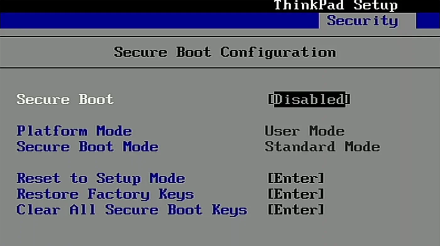

- Check if Secure Boot is enabled. To do this, press Win + R, enter msinfo32, and look for the line "Secure Boot Status." The value should be "On."
- Open Windows Update and install all available updates. Also check the optional updates section, as a newer firmware version may be available.
- Find your exact computer or motherboard model and check the manufacturer's support page. Only install the BIOS from the official website and only for your specific model.
- Before updating your BIOS, make sure you have your BitLocker recovery key. It may be stored in your Microsoft account, work account, or with your system administrator. Microsoft explains where to find it in a separate guide .
- If Windows reports that the rollout is temporarily stopped, it's best to wait for a fix. This is a security hold, not necessarily a download error.
- If you report a hardware or software limitation, please contact the manufacturer's support team. Older computers may require special firmware or a separate key update package.
